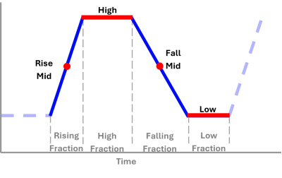

The Stop Location command parameter options are to stop at the Next Cycle, or one of the red positions shown below:
Next Cycle
This is when the current cycle completes, which is when the Cycles Axis Status register reaches a whole number. The location of the cycle completion is relative to the Start Location that was specified in the Trapezoid Start (130) command.
High
The Target Position will stop when the Target reaches the High position of the waveform. If the axis is already at the High position, the axis will remain stopped and the motion will be complete.
Low
The Target Position will stop when the Target reaches the Low position of the waveform. If the axis is already at the Low position, the axis will remain stopped and the motion will be complete.
Next High or Low
The Target Position will stop when the Target reaches the High or Low position of the waveform. If the axis is already at the High or Low position, the axis will remain stopped and the motion will be complete.
Rise Mid
The Target Position will stop when the Target reaches the middle of the Rising Fraction section of the waveform.
Fall Mid
The Target Position will stop when the Target reaches the middle of the Falling Fraction section of the waveform.
Next Rise/Fall Mid
The Target Position will stop when the Target reaches the middle of the Rising or Falling Fraction section of the waveform.
