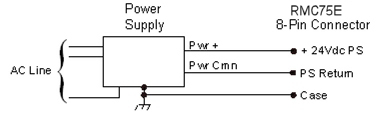

The RMC75E CPU module contains a connector for power, and two connectors for communications.
Wiring Power
The connector screws and wire clamp screws must be tightened to max 7 b-in (0.8Nm).
