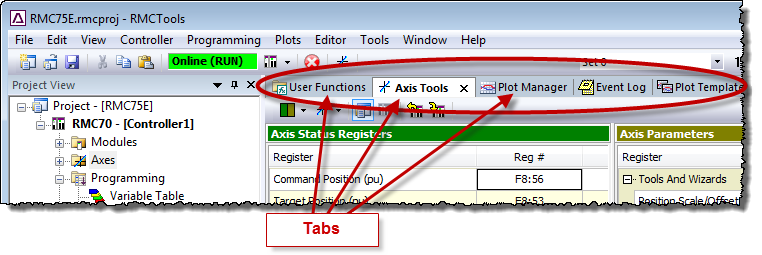

Tabbed Windows
The main windows, such as Axis Tools,  Plot Manager, etc., open in a tabbed format:
Closing a Tabbed Window
To close a tabbed window, right-click the tab and choose Close.
Splitting Tabs
To split a window into a new tab group, right-click the tab and choose Split Side-by-Side or Split Above-Below.
Moving Tabs Between Tab Groups
To move windows between tab groups, right-click the tab and choose Move to Previous Tab Group or Move to Next Tab Group.

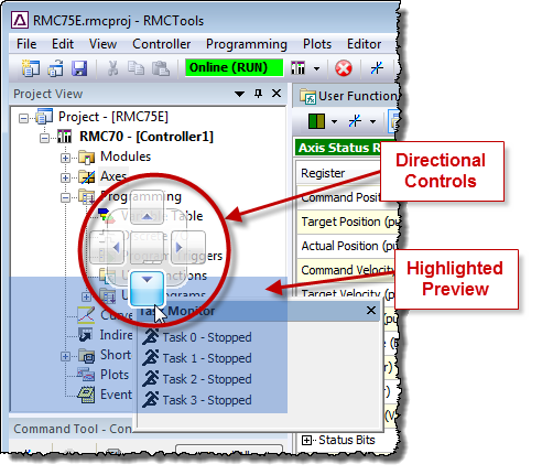

Moving Dockable Panes
To move a dockable pane, click and drag the title bar of the pane. As you drag, directional controls will appear. Dragging to a directional control will give a highlighted preview of the new pane location. Dropping on the directional control will place the window at that location.
Example of docking the Task Monitor below the Project pane:
Placing Dockable Panes in Tab Groups
To dock panes together into tab groups, move the pane to the center square in the directional controls.
