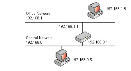

Suppose the device given in the above example must communicate with a device on a connected network with an IP address of 192.168.1.8.  Because the device is not on the same network there is no electrical connection between the computers so it cannot send its data directly.  Instead it must go through an IP router.  An IP router is a device that sends packets it receives from one network that are intended for devices on another network to the other network.  Here is the example intranet:
How does 192.168.0.5 send a message to 192.168.1.8?  The answer is that it must use a third parameter called the default gateway. This parameter is the IP address of the router who will take care of getting the packet to its destination. The rule for most devices is to send packets to devices with the same network address directly over its network, but to send packets to devices with a different network address to the default gateway. In the above network, the device at 192.168.0.5 would have a default gateway of 192.168.0.1, and the device at 192.168.1.8 would have a default gateway of 192.168.1.1.
